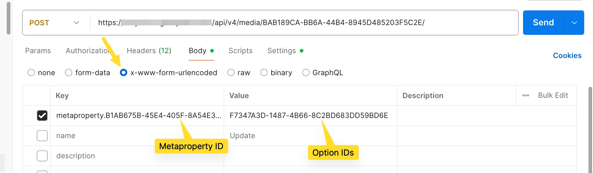

Hi ​@dbessy it could be two things:
  1. The body of the POST call needs to be in x-www-form-urlencoded format, not JSON (screenshot of Postman below)
  2. For the metaproperty updates, the format is to have the metaproperty ID as the key and the option ID as the value (also in the screenshot below)

Ah, got it! I actually had the encoding right, but I did not know that the keys needed to be in “metaproperty.id” format. Everything works now as expected, thanks for your help!
