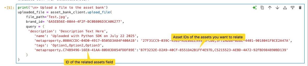

If you need further assistance we can submit a support ticket. The screenshot here shows how to the structure the Modify Assets or Upload call in the SDK to relate assets together (the same one we posted before but just in case you need it again)

Great to see you in the Community ​@Ronald.Knol! Thank you for taking the time to ask your question. For item a, it's true that the python SDK currently does not have the ability to upload additional files built it, but you can add the functionality and create a PR on the Github repo and we can possibly add it. For b, you can relate assets either during upload or modifying assets using the SDK the same way they add metaproperty options to assets. The format in the SDK for the query would need the metaproperty ID for the related assets field, then the values would be the asset IDs they want to relate to the asset. (Note that the asset ID for the related asset metaproperty will need to be converted from the Version 4 UUID format to the legacy Coldfusion format for it to work, or else you'll get an error when doing the call)

​@Ronald.Knol  Every portal will unique UUIDs for their metproperties and metaproperty options, including the one for Related Assets. We recommend to use the uppercase UUID format for the Related Assets field that you get back in the API - there is some inconsistency in how this UUID is returned in the Related Assets section in the admin page, and for the API call to relate assets together, it needs to be in the uppercase UUID format you gets back in the Retrieve Metaproperties API call.
To upload additional files to assets, you will follow the standard API upload steps, but at Step 4 you will do this call instead https://bynder.docs.apiary.io/#reference/upload-assets/4-finalise-a-completely-uploaded-[…]mpletely-uploaded-file-and-save-as-a-new-asset-additional (Note: you do not have to do the subsequent upload API calls for additional files) Please let us know if that helps!
