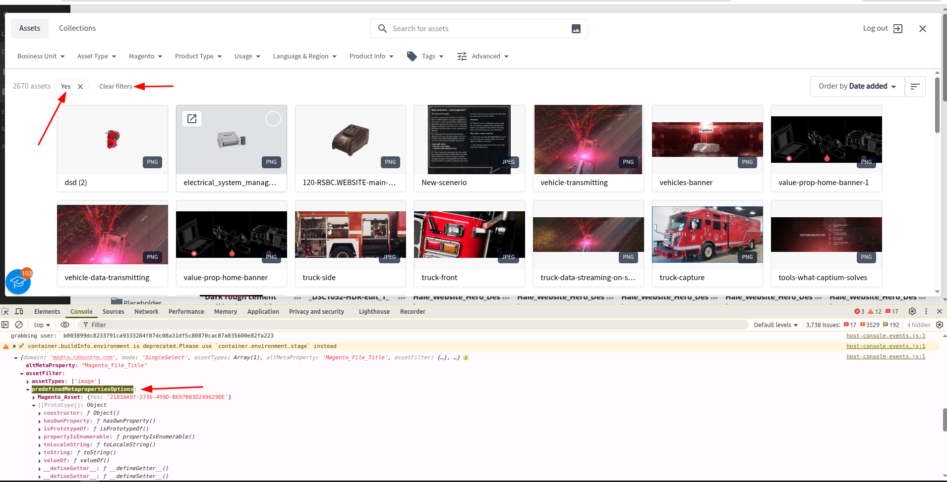

Integrated Universal compact view in my magento2 site.
I have a metaproperty called Magento_Asset with two options: “Yes” and “No.”. My requirement is to only display assets where Magento_Asset = "Yes" in compact view.
I attempted to use predefinedMetapropertiesOptions, which successfully applies the filter when the Compact View loads. However, users are still able to remove this filter manually — which I want to prevent.
Is there a supported way to enforce a filter on the Compact View so that only images with Magento_Asset = "Yes" are shown, and the user cannot remove or modify this filter?
Best answer by Ryanne Perry
Hi ​@palakpatel, thank you for taking the time to ask your question in the Community! Have you tried to use showToolbar boolean after predefined filter applied? I believe this documentation may be helpful to you here  dev-docs
